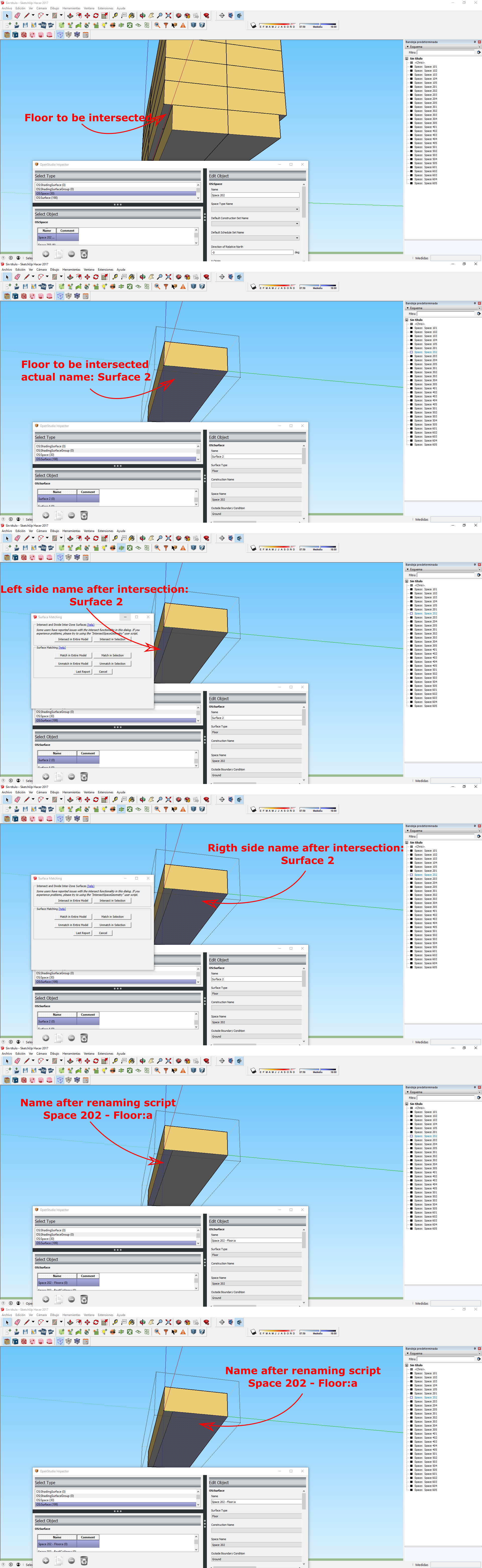

In the following link you will find and image with the full history:
link text
Any way, my guess is that this problem is not in the intersection script but in the openstudio "observers" of the sketchup geometry. Recently I have experienced problems resizing windows (in large models) that I didn't find before.
mapascual's avatar mapascual (2018-01-29 01:58:34 -0600) edit
I have just noticed that this is not a surface naming problem. The problem is that after intersection, both new sketchup faces point to the same OS:Surface.
The workaround is simple, after "intersect" delete one of the sketchup faces and draw it again. This can be tedious and a big issue for new users.
mapascual's avatar mapascual (2018-01-29 02:16:54 -0600) edit
