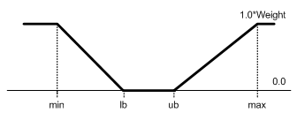

Constraint functions are used to test whether a solution is 'feasible' or not. You may consider them as a special type of objectives, whose values must fall within a range, [lb, ub], defined by the user. Normally you would need to enable 'scaling' in the constraint definition, unless your feasible range is <=0. The use of the five scaling parameters (lb, ub, min, max, and weight) is best illustrated in the diagram below. The algorithm considers 0 and below as feasible, and anything above 0 as unfeasible. It works to minimize the sum of the constraint values if more than on constraint are defined.

For your example: 1. set min and lb to 0, ub to 80, and max to some large number, say 500; 2. Yes, as lb and ub are only applied when scaling is enabled. 3. No. RVX overrides the objective definitions in RVI.
